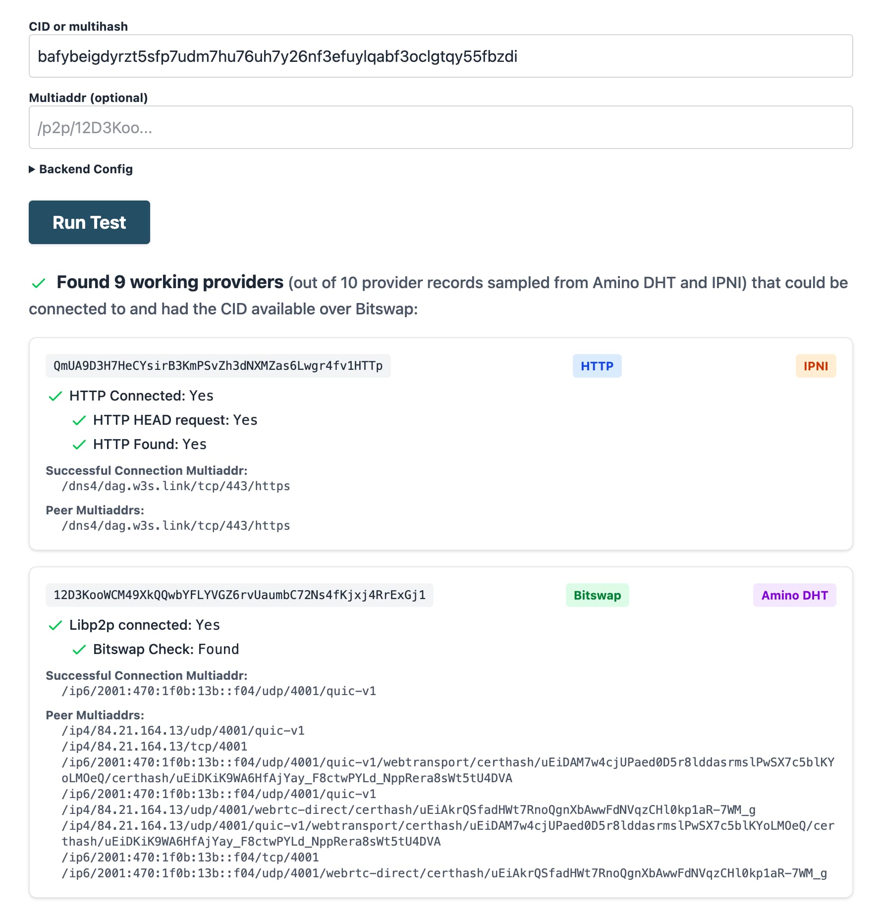

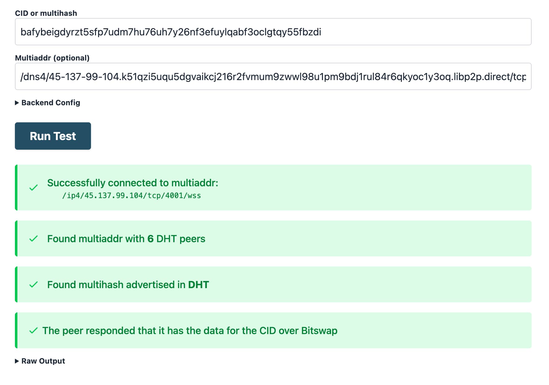

When requesting content with Kubo, nodes search the DHT for 'provider records' to see who has what content. Let's manually do that on node b to make sure that node b is able to determine that node a has the data. Run ipfs dht findprovs <hash>. We expect to see the peer ID of node a printed out. If this command returns nothing (or returns IDs that are not node a), then no record of A having the data exists on the network. This can happen if the data is added while node a does not have a daemon running. If this happens, you can run ipfs dht provide <hash> on node a to announce to the network that you have that hash. Then if you restart the ipfs get command, node b should now be able to tell that node a has the content it wants. If node a's peer ID showed up in the initial findprovs call or manually providing the hash didn't resolve the problem, then it's likely that node b is unable to make a connection to node a.
# Checking addresses

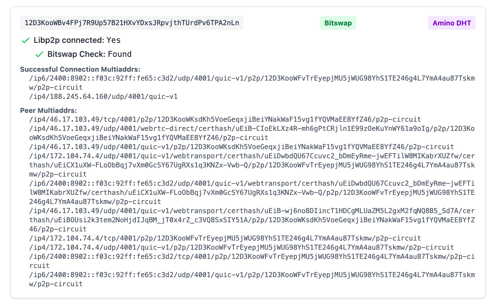

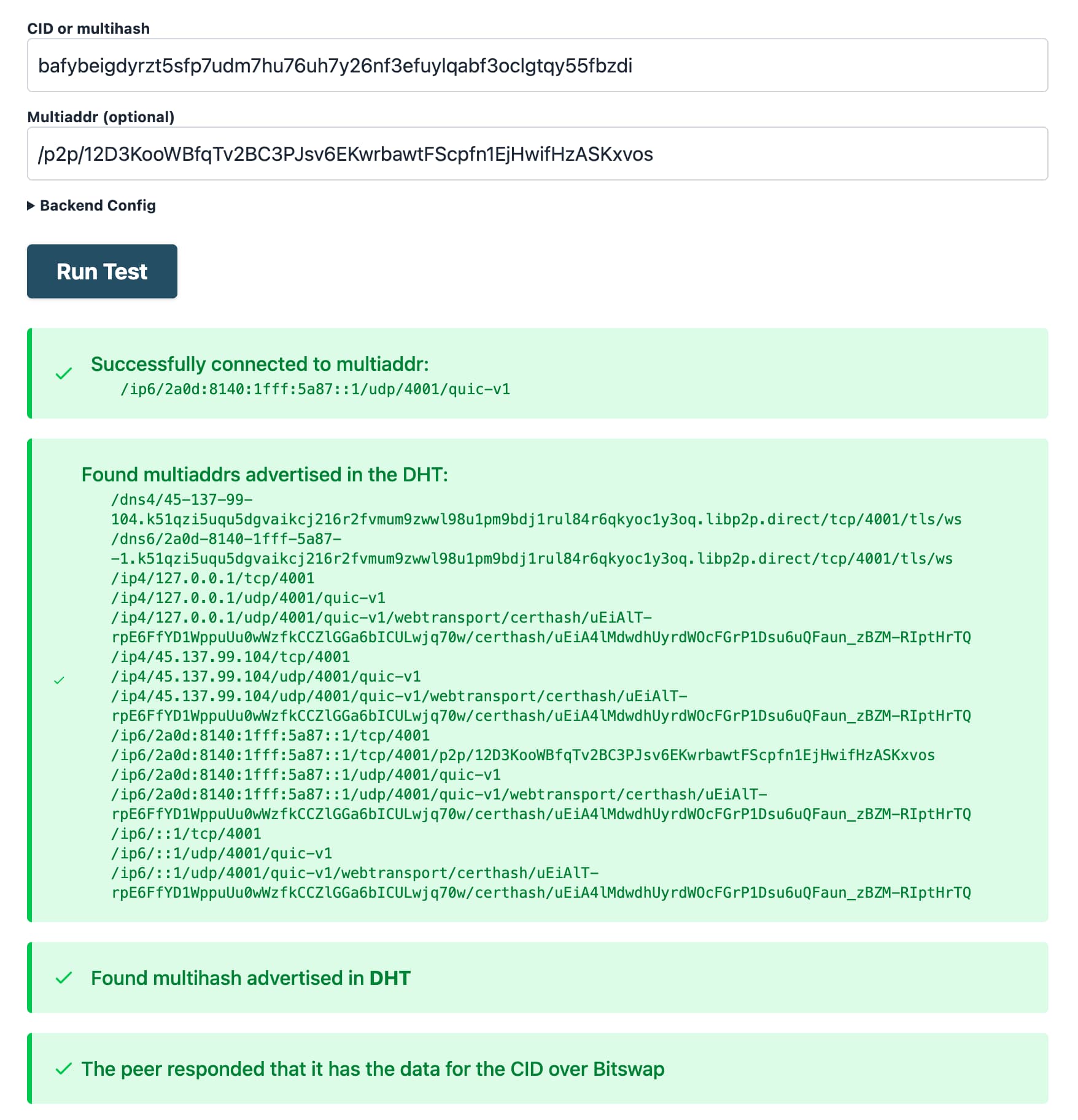

In the case where node b simply cannot form a connection to node a, despite knowing that it needs to, the likely culprit is a bad NAT. When node b learns that it needs to connect to node a, it checks the DHT for addresses for node a, and then starts trying to connect to them. We can check those addresses by running ipfs dht findpeer <node a peerID> on node b. This command should return a list of addresses for node a. If it doesn't return any addresses, then you should try running the manual providing command from the previous steps. Example output of addresses might look something like this:
/ip4/127.0.0.1/tcp/4001
/ip4/127.0.0.1/udp/4001/quic
/ip4/192.168.2.133/tcp/4001
/ip4/192.168.2.133/udp/4001/quic
/ip4/88.157.217.196/tcp/63674
/ip4/88.157.217.196/udp/63674/quic
In this case, we can see a localhost (127.0.0.1) address, a LAN address (the 192.168.. one), and another address. If this third address matches your external IP, then the network knows a valid external address for your node. At this point, it's safe to assume that your node has a difficult to traverse NAT situation. If this is the case, you can try to enable UPnP or NAT-PMP on the router of node a and retry the process. Otherwise, you can try manually connecting node a to node b.
